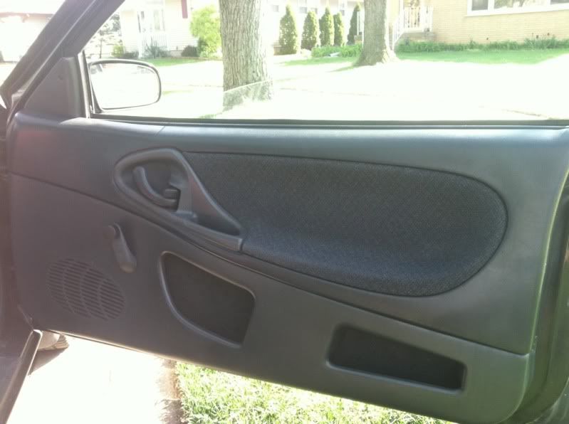

Finally got started with one of the installs today. Gonna try and keep the install period correct as much as possible.
1997 Cavalier ( the work car)
4.5" Boston pro series components up front
5.25 Boston pro seriesin the rear
Two 15" kicker solo barics ( the round ones)
Fosgate 4080
Fosgate 500m ( or two 200dsm)
Fosgate EPX2
Alpine 7987 ( only cause my 7949 doesn't play burned cd's)
We'll see how things go.
Work in progress

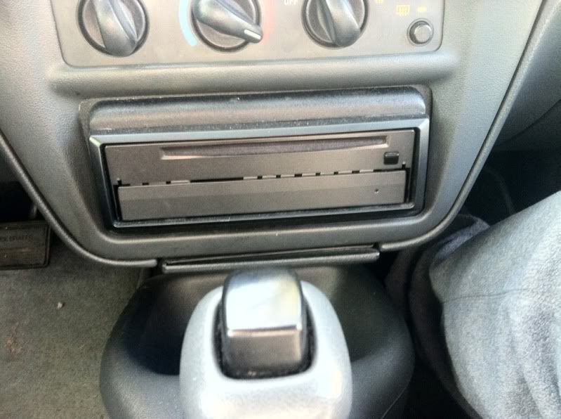

There are about 13 (7mm) screws that need to be removed to take the dash panel off before you can get to the hidden screw to remove the panel that covers the radio. Don't be that guy and destroy the radio cover not knowing about the hidden screw.
Come on homie, who you think I am?

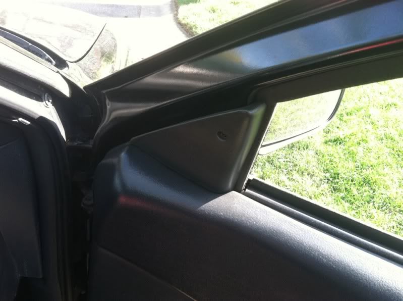

I wanted something that was plug and play. SQ isn't even a thought here but I will, as you mentioned, be keeping the subs at a lower level more than pounding. Those bostons have surprised me in the past though, with the tweeds mounted high up on the door they seem to be surprisingly bright.
Im thInking cutting the fronts off at 250hz and the rears off at 125hz. That would leave a gap between 80 and 125 since that's what I plan to cut the subs off at. Well play with it. It's just something for fun, I got to many other thongs going on to get balls deep in this install. I still have a feeling it will sound better than 90% of the crap installed out there!
