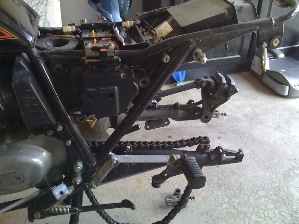

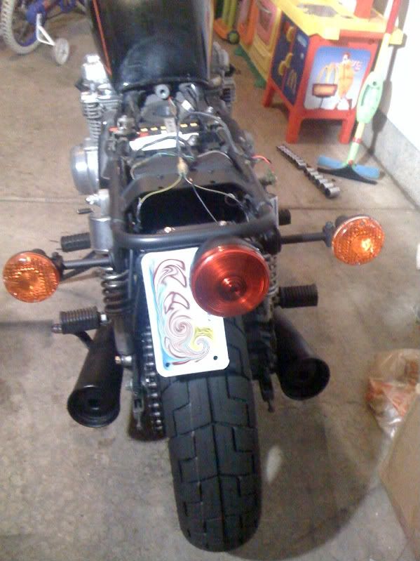

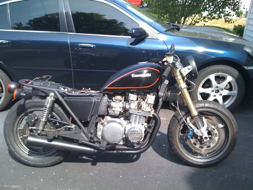

Quick and dirty version.
Contacted Z1 and will be going with custom short cables to clean the front end up alot, aswell as remove all unecessary wiring, and go with alot cleaner looking controls. All over winter of course . For now found a way to get the stock cables & lines routed so that they don't bind or pull. Didn't want to waste anymore riding days
Start with a Kawasaki KZ750
Pulled the side covers off, removed "LTD 750" and wrapped them in carbon fiber vinyl
Pulled the back wheel and seat off for a quick paint and recover, and to clean up the frame.
Everyone likes new rubber!
New All Balls Racing top and bottom bearings
Off with the old on with the new
Not a huge fan of the signals, but they will keep my legal for now lol
And finish the Yamasaki off with a shaved and recovered seat and painted exhaust.
The tank is pretty faded and has alot of blemishes so I will probably have that painted this year as that shouldn't take long, but that's pretty much a wrap for Yamasaki v1.0 lol

Was a front end a direct bolt on or did it require modifying the trees and specific bearings?
Agree on the cafe style seat.

For the most part it was. The most common front end swap for the KZ seems to be any GSXR front that has inverted forks, but figured I would give the R1 a shot as the price was right on the complete setup minus wheels. I did have to shave the stem ever so slightly because the bottom for some reason gets a little bit wider and the bearing wouldn't sit all the way down. Basically I took my dremel and made a few light passes until the "gold color" was gone in a few places and the bearing slid right down.
Nice, How does it ride?
Tripletree angles\offsets can sometimes throw things off.
Did you use spray adhesive to glue the cloth to the side cover?

I love the way it rides crusin around, nothing unpredictable or awkward like the preying mantis . Elbows are no where near my knees like I thought could happen and forks would never hit the tank. It turns in a parking lot just like a sportbike with similar bar clearance.
I definitely sprayed the top and sides of the seat with 3M Super 77. A good friend of mine use to work for Ford and got me a section of leather from the Ford Harley Davidson F series interior. So I just asked one of the nice old ladies at JoAnne fabrics if they knew of a way I could cover my seat, yet make it easily removeable. Lady said "lace it like a shoe"! So 26 gromets and a hammer later, I have a laced seat that's easily removable!
