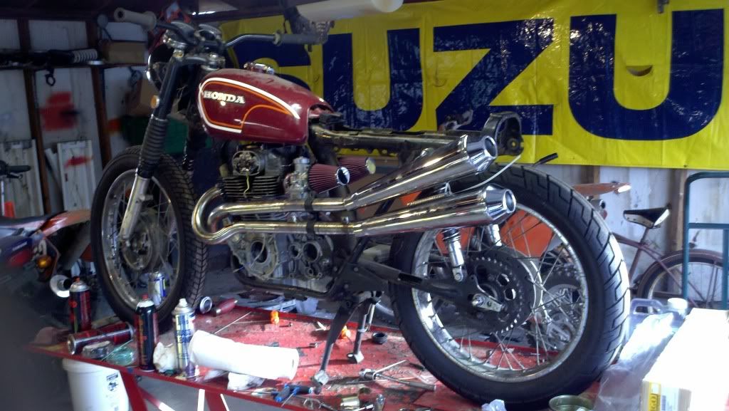

I temporarily assembled the empty engine and put it in the frame so I could put the exhaust on and weld some mounts to the frame for the new mufflers.
Can anyone tell yet where I'm going with this bike from the style of exhaust I'm running? The top pipe has the upswept angle I want but I'm going to have to bend the lower pipe or weld a bend onto it to get the muffler to sit how it is in the picture. I couldn't resist tossing the carbs on there too just to get an idea of how it's all going to look. I need to order the tail section so I can make mounts for it, then the whole frame can come apart for sandblasting, removal of unnecessary brackets and paint or powdercoat.
The cylinders I had were unusable so I grabbed a set from Ebay and will send them out to Mike to check them and bore/hone as needed.

the reverse cones up high make it look like a street tracker now and not a scrambler.

I think that's the intent!

I'm digging the pipes! and can't wait to see more pix as this progresses!

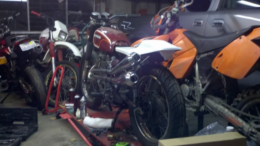

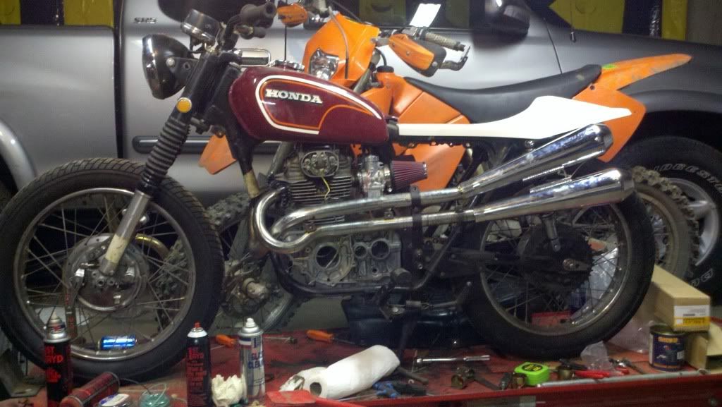

The new tail came today.
It's damn near a perfect fit. It will be sitting all the way up against the back of the tank when it's done. The fuel tank mount is in the way now, that's why it's slid back an inch or so in the picture. With it up against the tank the widest point of the tail sits just above the shock mounts like it's supposed to.
I'll have to remove the rear gas tank mounts from the tank and frame, and make new mounts that will bolt on from underneath. That giant hole at the back of the tank will also need to be filled in. Oh and that white flap hanging down under the rear of the tail is just the paper towels I used to hold the back of the tail up where it belongs.
