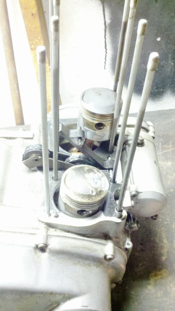

I began to disassemble the top end to see why it had no compression.
This is what I found:
I think I figured out the compression issue . Mao actually rode it home like this on the one good cylinder. It chewed up the piston but didn't even touch the cylinder walls:

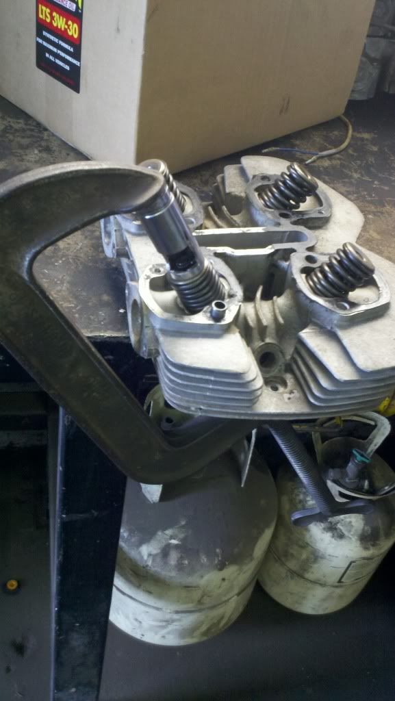

Today I took the valves out of the two good heads to clean them up and send them to the machine shop. I will let the machinist pick whichever he thinks is the better of the pair.
Homemade valve spring compressor:

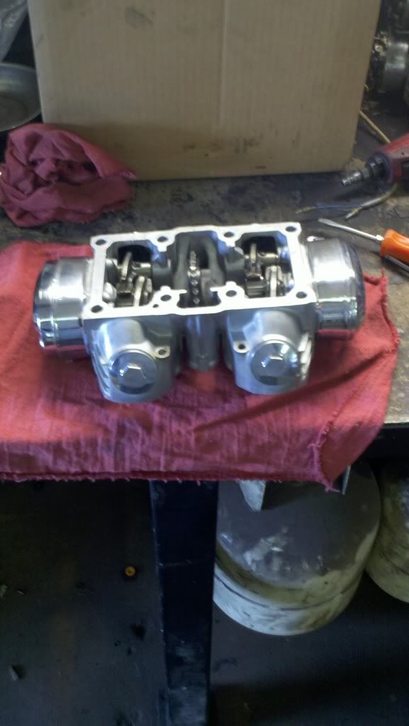

Temporarily reassembled the cam housing to keep the good cam and rockers together in one place until I get the bottom end done and assemble the whole engine. These 350 twins used two different style cams and rockers. I am running the early style because that was the only good set of cam and rockers I could find:

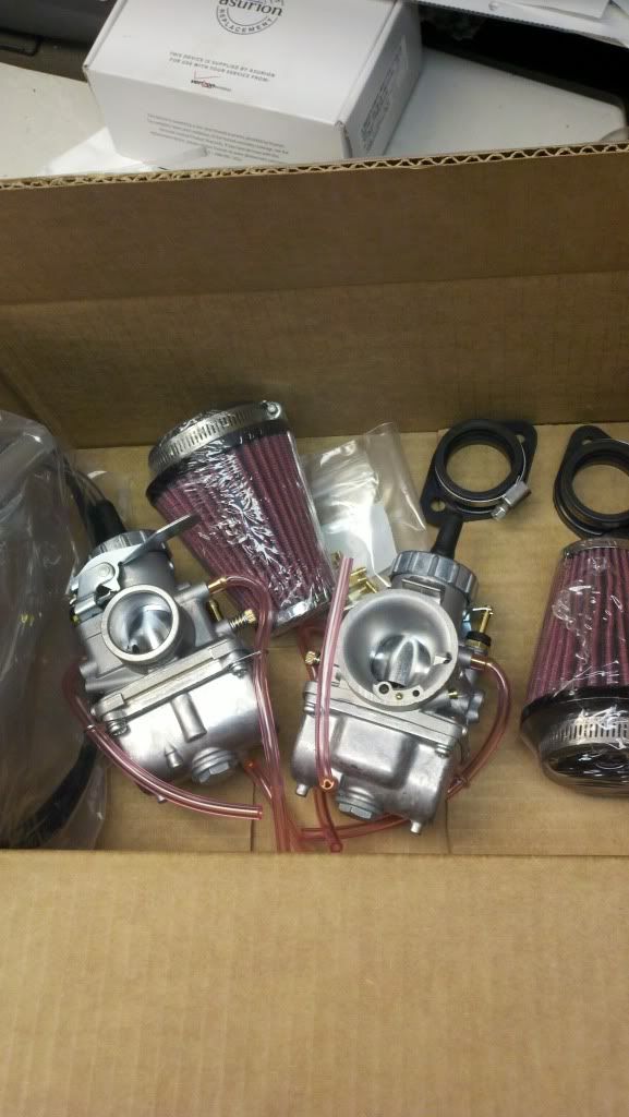

Got some parts in the mail this week. Cam chain, cam chain slider, and these:
Mikuni VM30's. I don't want to run an airbox and these will work much better with cone filters than the stock CV carbs would.

I agree. I wanted to eliminate the airbox and all the crap that sits behind the stock side covers so I can have that triangle area of the frame open, which coincidentally, also looks bad ass. It will be kick start only so I can ditch the stock battery that would also normally reside in that area and use a smaller battery under the tail.

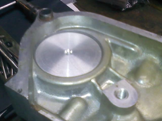

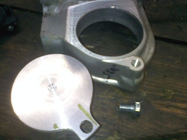

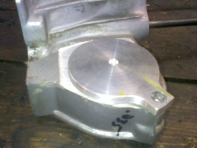

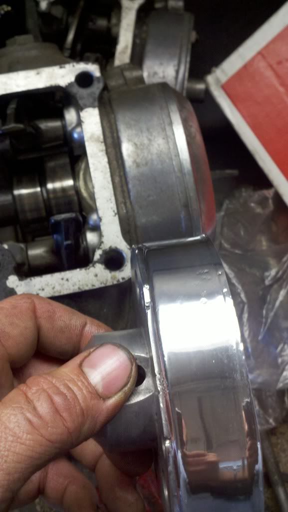

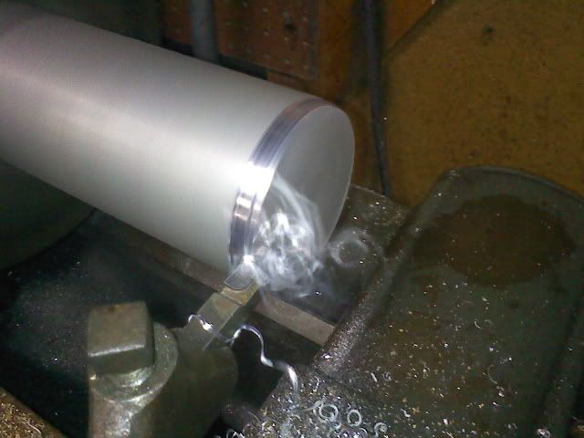

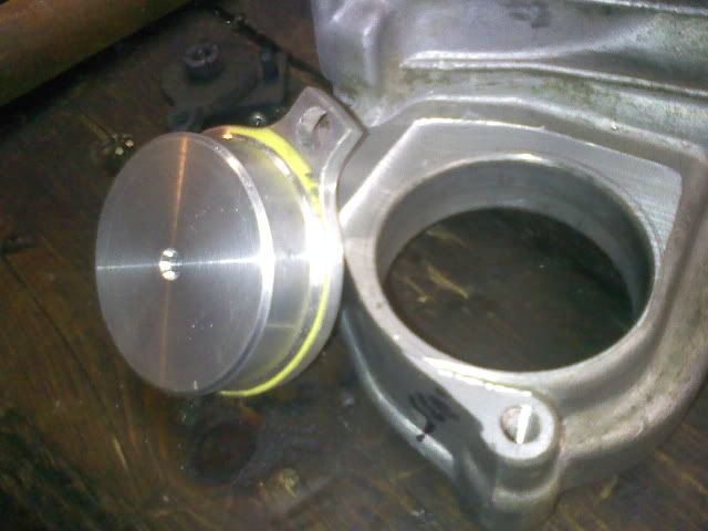

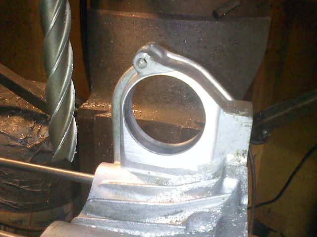

We have a plan I will machine a flat surface on the engine case. then fit a plug with tab for bolting to the case.
Photo's to follow.
post #23 of 61 (permalink) Old 10-31-2011, 08:11 PM
We are going to plug Ryans hole.
Don't laugh Vern.
First we indicate the angle plate SQ.
Then we machine the casting perpendicular to the starters mounting hole.
Next we machine the bolt hole parallel to the mounting face.
With the casting prepped We can start cutting our plug.
Tomorrow I'll fit the plug and spot the bolt hole.

Looks awesome so far Gus.
You are breaking your rules and doing this GOOD, CHEAP and FAST.

That's really smooth. Nice work Gus.

Perfect, just what I was looking for. Awesome job Gus, and only 2 days after you got the part in your hands .
