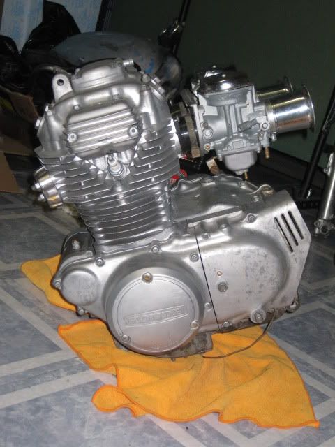

Sean is 100% right. I brought in my parts bike engine to Gus at Resurrection for glass bead blasting this past weekend. We found that it was amazing at taking off the old yellowed varnish and oxidation, but any sections that had built up 30 year old oil and grease did not get cleaned up that much. The parts of the engine that did get cleaned up have an amazing satin finish. Be sure to be liberal with your duct tape around the holes, I put on 3 layers and still found some glass beads around my intake and exhaust valves. I will post a pic later.

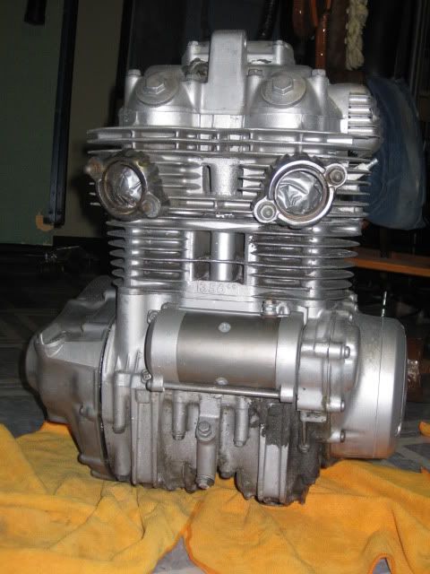

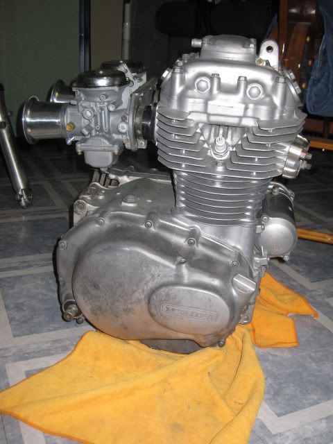

Once again, nothing to write home about, but a world of difference compared to how I got it. The cooling fins look GREAT!

looks great Mark
just give it another cleaning and an oil change .
I've had good luck sanding lightly in just one direction then a light steel wool to finish. Staying with the satin look.
post #24 of 30 (permalink) Old 09-08-2009, 10:31 PM
Looks really nice to me. Those sleeves cleaned up awesome.
