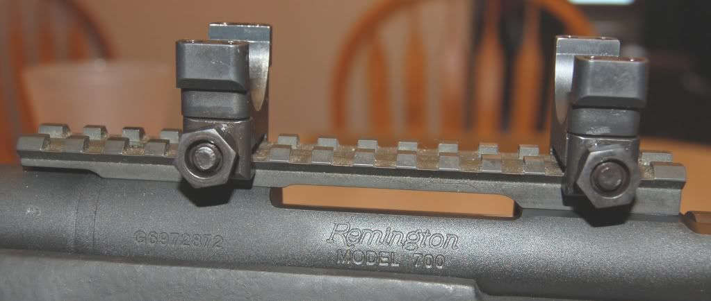

Badger Ordance 20MOA scope rail
Badger Ordance Standard height rings

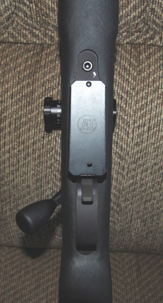

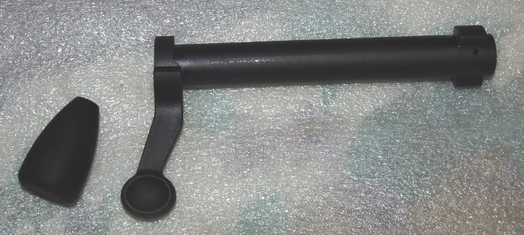

+++ Bolt handle had to be milled off and threaded to accept the new Badger bolt knob.
+++ Stock had to be inleted to accept the oversized Badger bottom metal
+++ 700 reciever had to be faced inside to accpet the detachable magazine

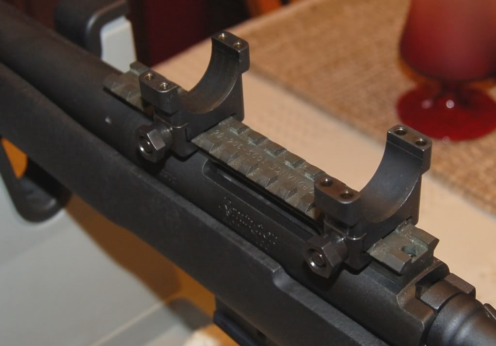

+++ 700 Reciever and bolt lapped to smoothen action

+++ Action mounted to stock and bottom metal, torqued to 65 inch pounds
+++ Badger base mounted and torqued to 18 inch pounds.
+++ Badger ring bottoms mounted and torqued to 65 inch pounds
+++ Bottom half of rings lappd to ensure 100% contact to scope body and no binding
+++ Scope erector body paralled to badger base
+++ Ring caps torqued to 15 inch pounds

Bolt knob b4:
Bottom metal inlet job:
Scope base and bottom rings installed:
Lapping process:
Lapping complete:

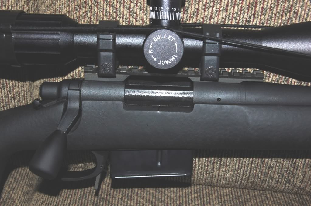

Complete rifle:
Close up of bolt handle, action, scope mounting and bottom metal:
