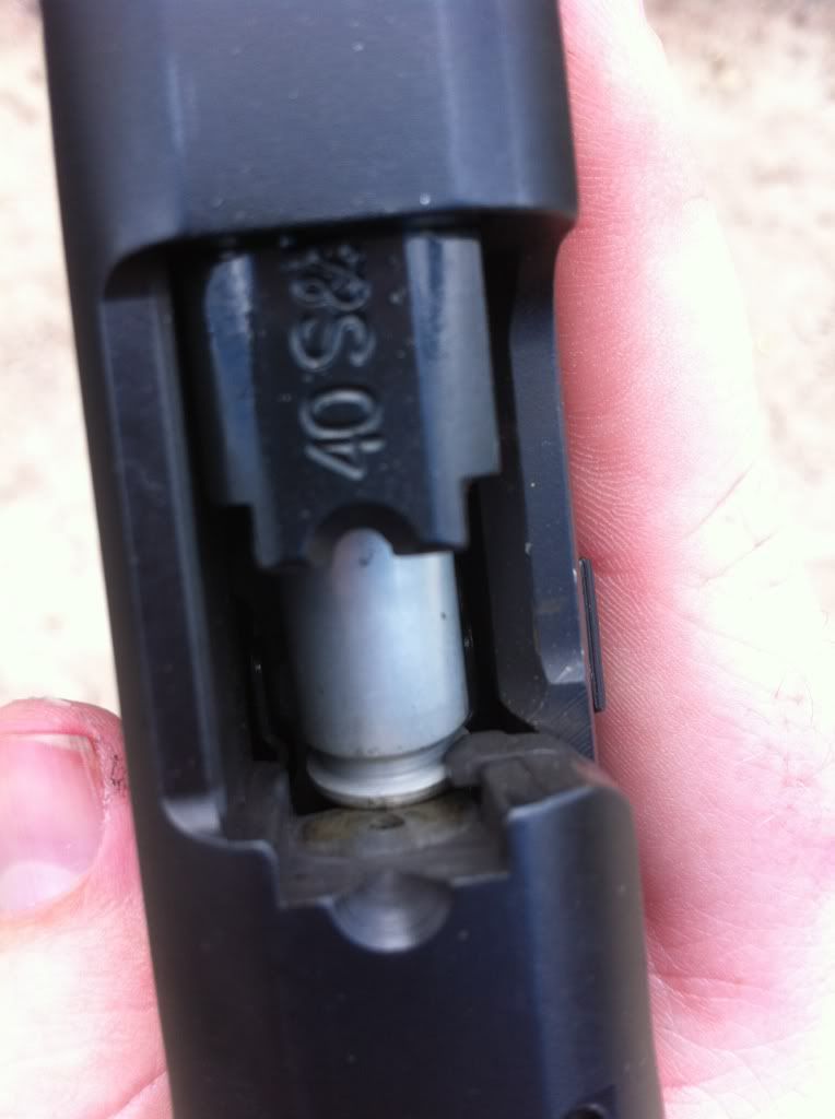

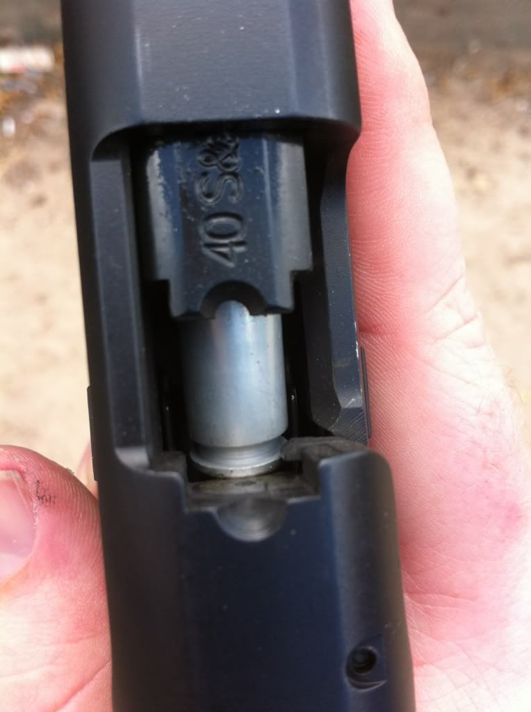

This gun my brother originally bought as his duty weapon in middle 09. He kept having problems with it failing to go into battery so he switched to glock after the academy. He sent it back to S&W and they sent it back saying it was fixed. He has shot several types of ammo and tried brand new magazines and still the same problem. He has shot it once since getting it back and we shot it again today. This is what we got six times in 3 magazines. Any insight is welcome.

Where is it catching exactly?
Have you tried some brass instead of steel ammunition?
If you take the barrel out, can you drop a round in the chamber by hand without it hanging up? It should go in smoothly and make a plunk sound.
If the chamber checks out OK, I'm going to say it's possibly a mag issue. The feed lips might be bent not allowing the round to hit the ramp and enter the chamber at the right angle. The follower could be backwards or weak spring or something goofy as well. Try different mags and different ammo. It may just be a picky bitch.

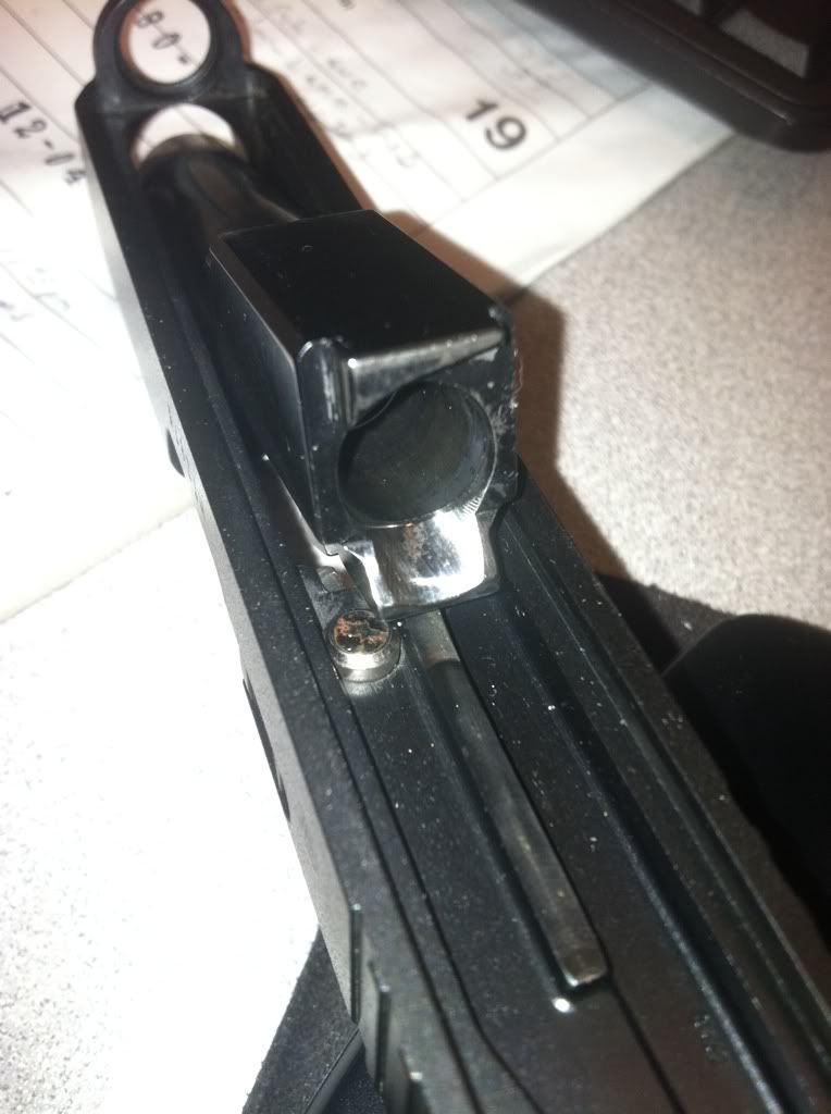

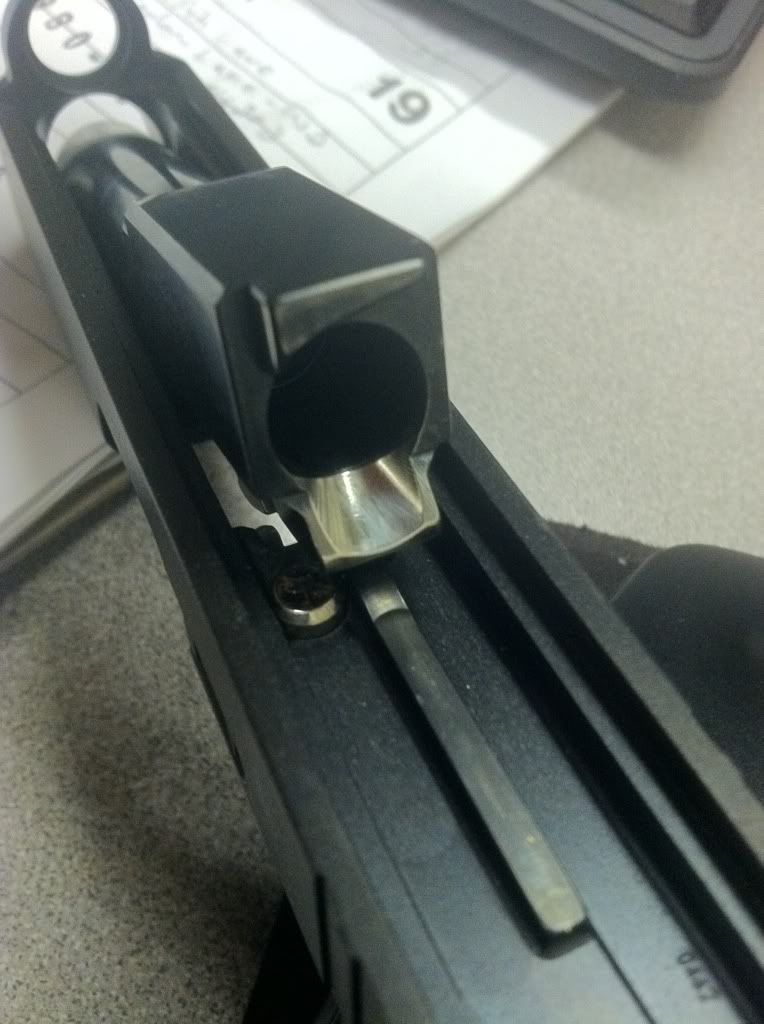

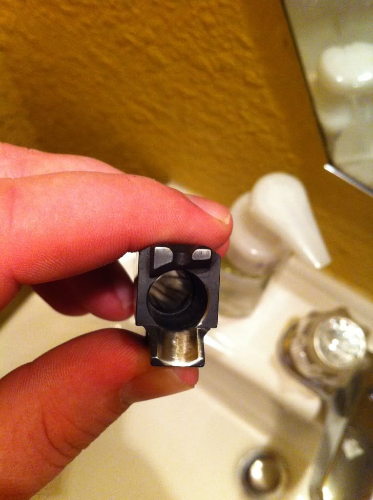

Not always the case as the rim of the case slides behide the extractor. it's a timing issue when it comes to the rim going behins the extractor with the gun going into battery. I posted a video on a different thread earlier this year if you wanna look that up. Use your finger to press against the extractor, even if you have to oush hard if the extractor budges at all your ok. From what you desrcibed and what it looks like I would be checking the feed ramp and chamber on the barrel. If the barrel is not ramped properly or the chamber not throated right this could very well happen. One way to check this would be if you have someone else with the exact gun toss their barrel in your gun and fire it.
Anyway you can get a pick of the barrel for me?

I haven't cleaned it just wiped it down for the pic.

here's what I had to do to a glock of mine to get it working 100%. Based on the picture you posted there are a few spots I would hit on that barrel.
post #9 of 18 (permalink) Old 05-09-2012, 10:03 PM
i would break the edges at the red arrows, open up the chamber a hair and blend. Clean up teh ramp and make sure it was rolled into the chamber nice and clean at the green arrow.
