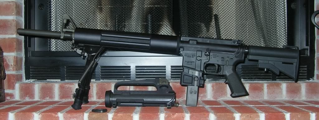

Started as a Colt A2 HBAR
Retained the barrel, bolt carrier group.
Added a RRA A3 upper and free floated the barrel. No b4 pics, just after.
His upper, my lower.
Spare parts in this pic shown as well.

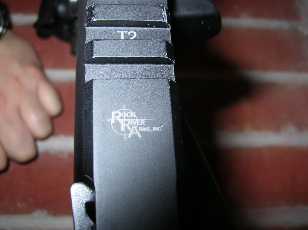

Stamping:

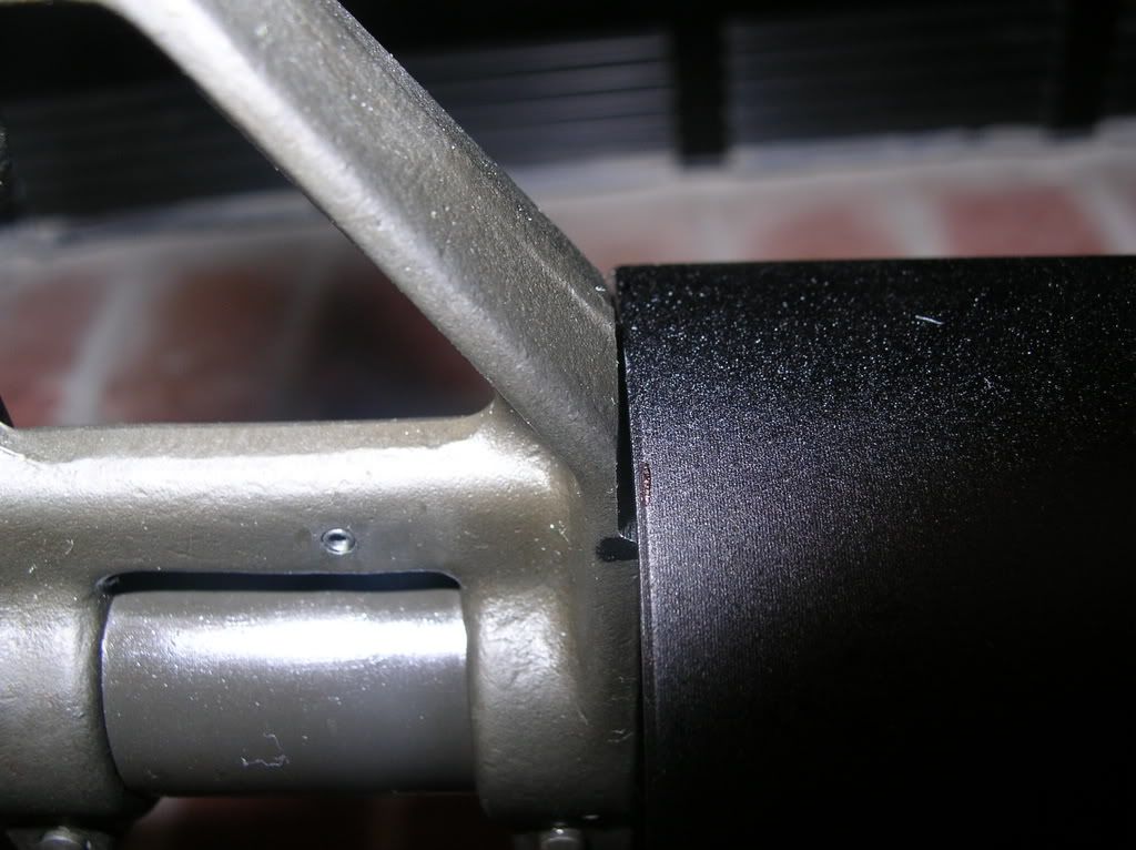

A little fitting to make the parts work together:

Looks good I have a Harris for it I am happy to see it has the lug.
Looks very good can not wait to get it.

On this build the FF tbe was a hair longer than the barrel would allow so I had to shave down the FSB to clear it. That's the 3rd pic. Also, the bolt headspaces on the barel extension so you wana be able o check that as well. Not all upper recievers are the same so headspace may change a bit.
