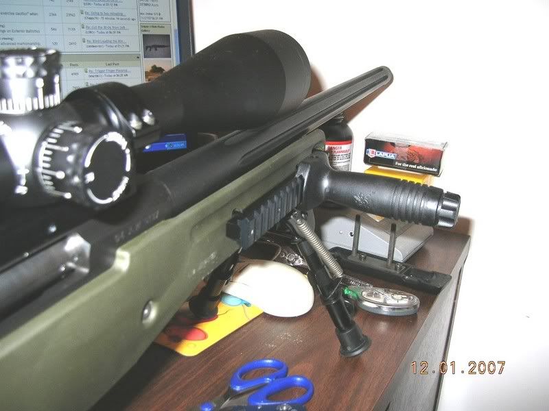

You made a comment aboutthe dovetail design scope mount on your airgun and not liking it, why? That's a proven design that has carried over to several rimfires.
As a matter of fact AI still uses a dovetail on their AW and AWSM series rifles. These go from .308 all the way up to .338.
About the only down fall is the limited choices of rings here in teh states. Not an issue with the AI stuff but we're talking $10 kit. So what's up with the dovetail?
Hers a bad pic of one of my AI's. These mounts run the full length of the dovetail and hold zero like no other.

Spring guns can distroy a scope.Something with the spring stoping at the end of its stroke causes many scopes to fail.I've never had any trouble mounting them on a dove tail.
Tasco has had some bad press but they have replaced free of charge several scopes for fello air guners in the past.
Befor buying any scopes
post #3 of 5 (permalink) Old 12-09-2009, 10:47 PM Thread Starter
Spring loaded airguns recoil forward and backward due to the spring piston. Rifles only recoil backward as after the bullet is expelled there is no forward force excerted. Airgun rated scopes have the optics anchored down in the front and back of each piece as rifle scopes only have anchors in the rear.
Thats the diffrence in a nut shell. Funny how a spring loaded airgun could destroy a scope faster than a .50bmg
