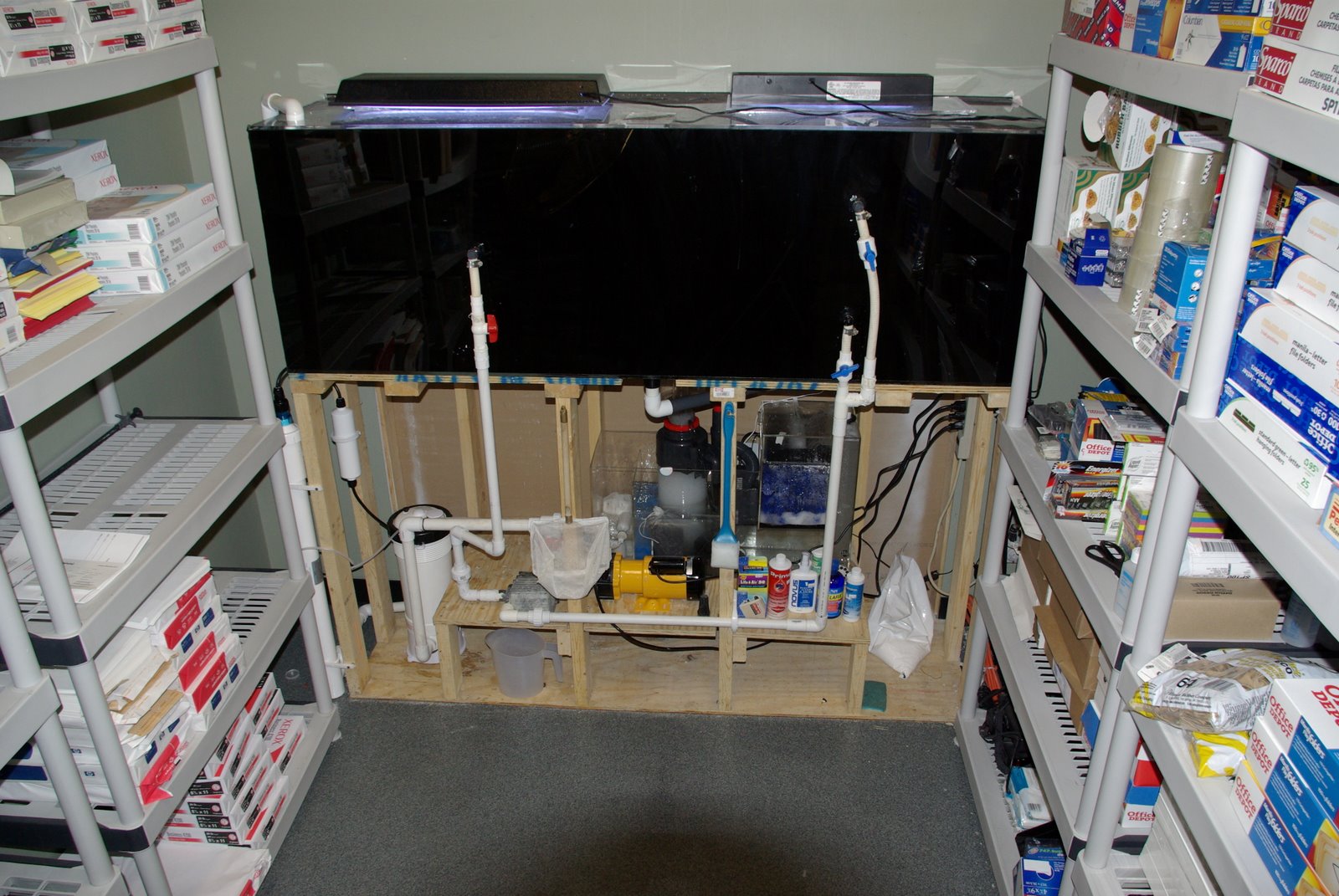

Explain to me what I am looking at
Please.

the back of a saltwater tank mounted in a wall

Yes, yes, and the specifics of the piping system?

the back side of a marine fish tank that is mounted in such a way as to be flush ot inset to the opposite side of the wall, the back side of the tank is located inside of a closet containing shelving upon which office supplies are stored.
the yellow thing is the pump, behind the pump is a sump type filter setup with built in protein skimmer(grey thing)
on the farthest the vertical white tube looks to be a UV sterilizer.
the larger fatter cylinder to the right of the UV sterilizer is likely a filter/reactor type unit used to dose the tank with probably minerals, and along that likes ill bet there are living corals in this tank although the lighting on top would seem to be inadequate for that but i could be wrong
can you get a front shot?

the white canisters on the left are UV sterilizers, the bigger box in the middle is a bio-ball filter

One thing i don't get on the setup above are the two connections on the left hand side. Why two? They are headered together anyways.

flow control
looks like they are returns - they can be turned up or down, on or off.
A lot of the plumbing appears to be hidden in the shot - just from a quick look it appears that's a little closed loop circuit just for circulation? It doesn't appear to branch into the sump - just to a pump and then through
