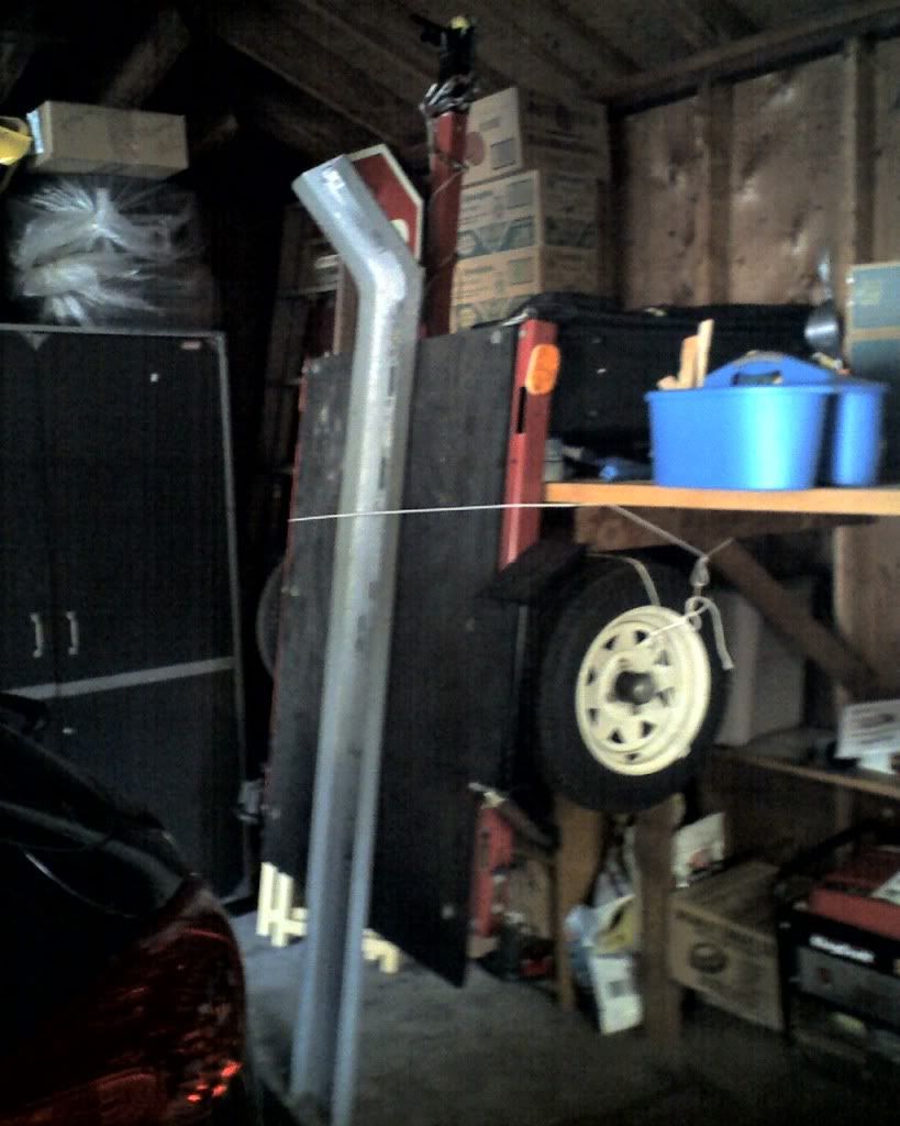

Thanks for the heads up guys! Here's the trailer.
[IMG][/IMG]

I saw that. Definitely a nice trailer but well out of my price range. The trailer pictured the seller is asking $235. And you know I'm gonna use my Jew skill to get the price down.

looks like that rail may need to be moved foward a little. Just check to be sure you have enough toungue weight.

that looks scary......
maybe just a bad pic

Do you know the dimmensions of that trailer? It either has large wheels (good if it does) making it look short or it is very short and that is why the rail is hanging of the back like that.
If it turns out ok, it would be cool if you could hinge the end of the rail to function as a ramp, one less thing to buy/store/transport.

that would be a steep ass ramp. probably nearly impossible to get a bike up and it would likely snag on teh belly of the bike and lip of the trailer

12" wheels with an 80" motorcycle rail. I'm not sure what the wheel base is on my SV. The PO was using it for his sportbike.

Taking another look, yep you are right, but still think a great idea. Just needs to give a call to Mr. Pilotx1 to fabricate some kind of extension for it that hinges in two extra pieces and he'd be set.

buy/ find another rail section, hinge it and put a pin thru it to lock it up vertically as a 1 peice ramp, much like on the open landscaping trailers

If that one is starting to develop some cancer, don't be afraid to sandblast it down & put on some new paint. Rustproofing the bottom helps.
